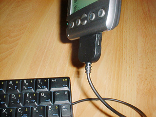

My answer is a double edged "yes." This keyboard is extremely high quality. It can stand up to your daily rigors and come out unscathed. The component that attaches it to your Visor plugs in
very well. It doesn't take nearly as much effort as plugging your Visor into a Stowaway keyboard. The attachment is quite minimal, but functions like a dream.
It connects to the Visor and will not come detached until you press the two
buttons on either side of the connector.
