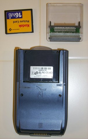

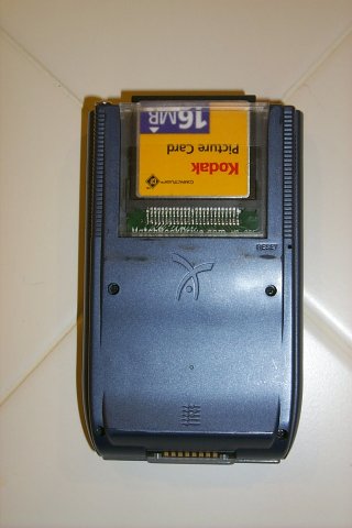

 It's a clear Springboard casing, rather than the typical black.  But, it's important to note that the MatchBookDrive isn't a true "Springboard" as it contains no software, and doesn't install anything when inserted.  It's merely an adapter.  More on the software you'll need later.  As with all modules that use this standard casing, it fits well and snugly into any Visor.  I've used it in a Prism and in an Ice Visor Deluxe, and it doesn't add to the thickness of the Visor, and adds immeasurably to the weight. I've started keeping it in my Visor Prism all the time, and I don't even think about it now.
CF Cards have small recessed grooves running along their sides.  The MatchBookDrive has two black posts with notches that slide directly into these grooves.  The trick is making sure they mesh perfectly, which guides the CF Card on to the MatchBookDrive's pins.  If you push too hard or too fast, you'll bend the pins. MatchBook Products told me that you can open the module a few times if you need to and straighten bent pins, but they recommend caution, as you might break the snaps that hold the case together.  I decided against opening mine.  If you just take care when inserting cards, it's not a problem.
