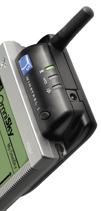

The Minstrel S is a CDPD (Cellular Digital Packet Data) Modem. It is spec'ed to run at 19.2kbps full duplex. When you add in the latency for the open-up and tear-down for each connection, the sustained speed of the modem doesn't mean as much as you'd think. The modem adds about 1/3" to the thickness of the Visor.
The battery life on the modem is amazing. I was unable to get it to run out over several hours of web surfing. I've heard numbers from 8 hours to 11 hours. Either way, it's a great lithium-ion battery, and if you charge it every day (like I do my Prism) it will probably serve you all day long. I used my Prism/OmniSky combination almost exclusively as my primary system for a while on the road without any battery incidences.
There are three LEDs on the modem. Starting on the left, is a green led that indicates signal strength. When it's blinking the modem is looking for a connection, when it's solid the modem has a connection. In the middle is a red led that indicates if you have waiting mail. When you've configured your POP/IMAP Email and told the OmniSky servers about your accounts, the modem can wake up (without waking up your Palm) and check for waiting mail at a configurable interval. This feature is cool, but seems to work intermittently. The third green light indicates when the Modem is charging or fully charged.
