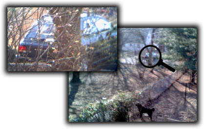

Can't be possible? Check this out...I swear it hasn't been altered...
When you line up the two lenses, you can still use the viewfinder on the Visor.
It displays wherever the binoculars are pointing. The enlarged photo was taken
with the E2 and a 8x21 pair of Tasco binoculars. The second image was taken
without the binoculars to give you an idea of distance. The only editing done
to these images is some cropping (it is possible to pickup the circular pattern
of the eyepiece in your image). The car you see in the image is more than 100
yards away. Based on this rough prototype, I think you could actually build
a telephoto lens for the E2.
